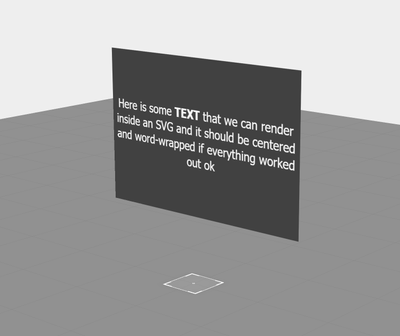

Based on your comments (and others), here's my attempt at dynamically creating an SVG for text. It works in "Preview" and on the HoloLens2.
First, I added a "3D Image" to my Canvas named "3DImage-1". I set the source to a random SVG file that I found.
Next I added the following functions to Home.js:
// This function accepts an image widget name (imgWidget, ex: '3DImage-1')
//   and some text/HTML (imgText) to render as an SVG image on the widget.
//   There are optional arguments for basic features like background color,
//   font color, font size, etc.
$scope.renderSVG = function(imgWidget, imgText,  bgColor='#414141', fontColor='#FCFCFC', fontSize='xx-large') {
  // Simple 600x400 SVG image template with a foreignobject section to embed HTML (text).
  let svgData = `<?xml version="1.0" encoding="UTF-8"?>
  <!DOCTYPE svg PUBLIC "-//W3C//DTD SVG 1.1//EN" "http://www.w3.org/Graphics/SVG/1.1/DTD/svg11.dtd">
  <svg
    id="svg1"
    crossorigin="anonymous"
    xmlns="http://www.w3.org/2000/svg"
    xmlns:xlink="http://www.w3.org/1999/xlink"
    xmlns:xhtml="http://www.w3.org/1999/xhtml"
    width="600" height="400" >
    <foreignObject x="0" y="0" width="600" height="400">
        <xhtml:div
          id='svgcontainer'
          style="margin:5px;padding:5px;height:380px;display:flex;justify-content:center;align-content:center;flex-direction:column;font-family:Tahoma,sans-serif;font-size:${fontSize};text-align:center;background-color:${bgColor};color:${fontColor};">
          <xhtml:p
            id='svgtext'>
            ${imgText}
          </xhtml:p>
        </xhtml:div>
    </foreignObject>
  </svg>`;
  // Base64 encode the SVG template defined above and create the SVG URL
  let svgURL = "data&colon;image/svg+xml;base64," + btoa(svgData);
  // Set the image widget to the SVG URL
  $scope.view.wdg[imgWidget].src=svgURL;
// Verify the renderSVG function works by setting a 3DImage widget to text.
$scope.sampleSVG = function() {
  // Name of image widget to edit
  let sampleImgWidget = '3DImage-1';
  // Text to render on 3DImage widget
  let sampleText = 'Here is some <xhtml:b>TEXT</xhtml:b> that we can render inside an SVG and it should be centered and word-wrapped if everything worked out ok';
  // Render sample
  $scope.renderSVG(imgWidget=sampleImgWidget, imgText=sampleText);
// After the document has loaded, change the image to the sample SVG
angular.element(document).ready($scope.sampleSVG);
Preview OutputPreview Output

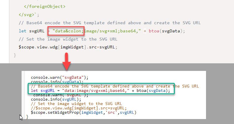

Hi @AndreaT ,
I think the code is working fine but there is an issue in the format of the community editor.
the problem is that the editor always change this code - therefore I will add it as picture there:
I think  the example from @JG_9770075 is working fine and was added with the correct code but unfortunately the editor corrected it so that it was not working in this context  . The picture on the bottom is the correct syntax

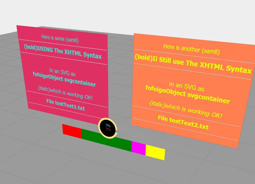

e.g. the one text file is something like this <testText2.txt> in the upload folder:
<xhtml:small>Here is another (samll)<xhtml:hr/></xhtml:small><xhtml:b>(bold)Ii Still use The XHTML Syntax <xhtml:hr/></xhtml:b> <xhtml:br/>in  an SVG as <xhtml:b>fofeignObject svgcontainer</xhtml:b><xhtml:br/> <xhtml:i> (italic)which is  working OK! <xhtml:hr/></xhtml:i><xhtml:b>File testText2.txt <xhtml:hr/></xhtml:b>
and here the result in preview
I attached the demo project here.
please, pay attention that editor changed the code and if a copy and paste is used it needs correction2022-10-20_14-23-19.jpg
or you can take the code from the example project
