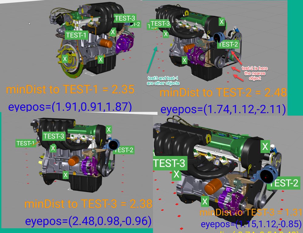

Hello @Lucas ,
here is an example which should demonstrate the principle of such solution. It definitely not perfect. Here I used a couple of 3d widget ( any 3d like label, image etc.) and display them as path showing the direction to an object. Here the objects are 3D Text widgets with specific coordinates. Depending on the position of the device it will display the distance to the nearest object.
The disadvantage of such solution is that for the path we need to define axillary widgets. Here I used per path 6 -> 3d Widget. So another option is to define only one path which will be displayed to nearest widget.

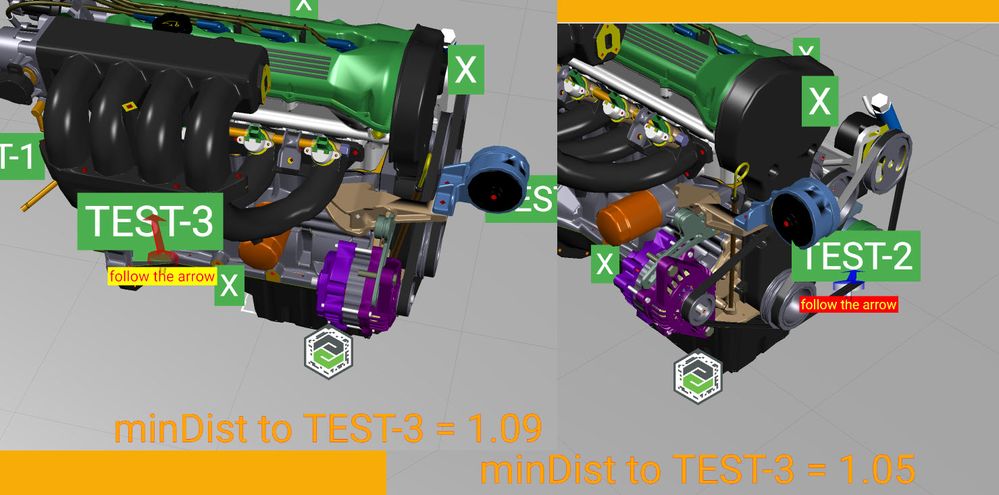

Hello @Lucas ,
I agree that this is not trivial and there is no best solution. We can try different things so possibly with some consideration and trial and error we can achieve appearance which could be used. We need to calculated the angle to the gaze vector the Euler angels to the vector -some matrix transform mathematics.
Here is an another suggestion – demo project which is ok for me. It will scan a widget with specific name (containing some string) and will find which the nears to the device and will display a arrow item with a text(move and rote it) so that it could be used as hint . I hope this is helpful
I attached a sample project to the post.
