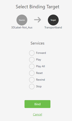

Hi @TP_9428687 ,
just to clarified you want to call a service to a model widget here the name "Transportband" right?
  1. - so calling only this service you do not need to use really javacode but could bind directly your button to the desired service. This will not make an difference so far I know
  2. To play anything - you need a sequence (that what is saved as pvi file inside the pvz model file) You can extract the pvi file from there and saved it in the upload folder. sometimes I had an issue where this was workaround for HoloLens device
  3. when you use the services play , or playAll of Modelwidget - this requires that the sequence is set at the current time - the sequence property should point to one of the defined figures /where we have the correspoinding pvi file (pvi file should be generated to specific pvz - only for this pvz it work)
