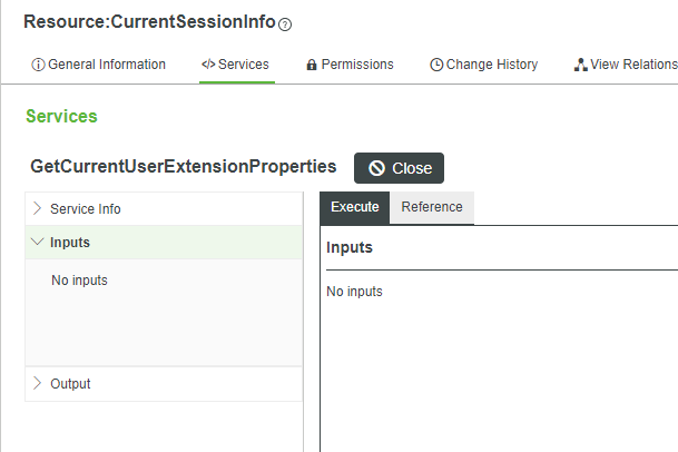

Can anyone please look at it as i want to execute this service from RESOURCES in vuforia studio but i am unable to execute it. Request is not going.
  $timeout(() => {
    twx.app.fn.triggerDataService("CurrentSessionInfo", "GetCurrentUserExtensionProperties");
  }, 100);
     $scope.$on("GetCurrentUserExtensionProperties.serviceInvokeComplete", function (evt, arg) {
    let result = $scope.app.mdl["CurrentSessionInfo"].svc["GetCurrentUserExtensionProperties"].data;
    console.log("Jamal Ashraf"+result);

I got the solution but thats strange because service itself does not have any parameter in thingworx but it needs parameter to run as below you can see:
 var params = {"type":"Things"};
    twx.app.fn.triggerDataService("CurrentSessionInfo", "GetCurrentUserExtensionProperties",params);
  }, 100);
now it is working fine as expected.
  }, 100);

sure that empty param will not work? - so at least it should be a json when ever it could be empty when not arugment required
var params = {};
 - so think issue form Vuforia side not form thingworx
