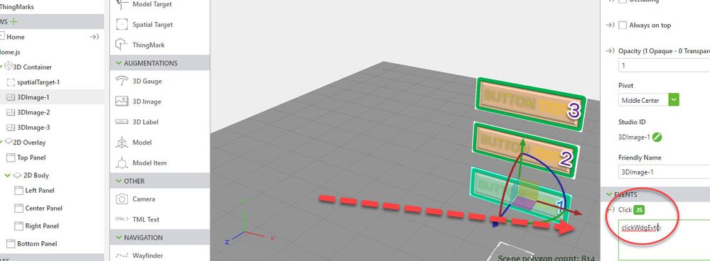

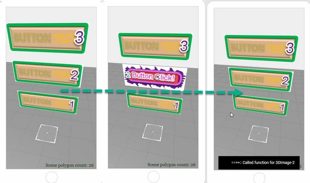

 the most trivial usage is to set a callback js function which is specified in the js section of the 3DImage widget. So when you click the specific 3Dimage it  will call this - what is specified in the js box
here I want to provide an example which use js script and the concept is more generally a button is identified by its name (the widget name - e.g. 3DImage-1) and will call a function containing the name (so it is better scalable when you have n buttons).

Hi @newieKek ,
