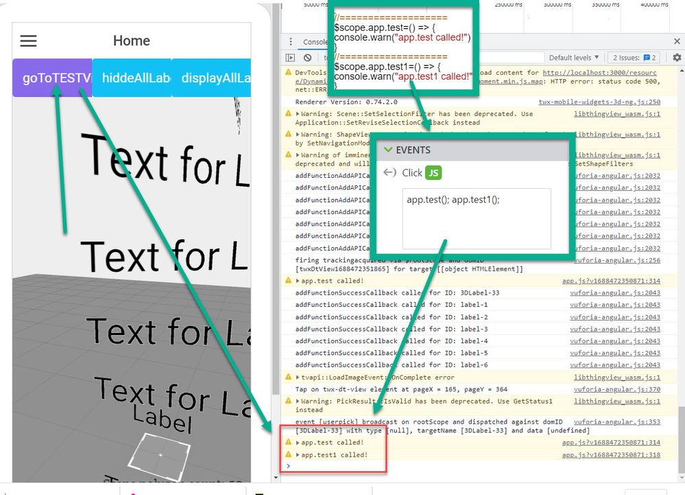

Can we add multiple JS in events
Rakesh_kumar_S
Can we add the multiple JS in events
It should actually work:
But it should be better to group the both function in the js code - function defintion
$scope.app.myNewFunction= function(){
$scope.setSequnece("sequence1");
//or $scope.app.setSequnece("sequence1");
// if defintion in app
$sope.B1();
and then call app.myNewFunction(); in UI
