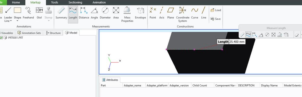

I checked further and create a Creo Paramter Cube with 1x1x1 in inch. So saved it /export it to PVZ format and open in Creo View to check:
So we can see that Creo view attributs contains informaiton about the units and it is scaled to mm means 1/1000 meter . The one inch is converted then to 25,4 mm
I hread some statements that pvz is unitless in meter and functionality e.g. measurement display as in picture there is calculated based on the attributes setting- in that case the dimension should be not 25.4 mm but 0.0254 meter as number , but could not verify that
Unfortunately I have no much experience with inch units becasue I my self use only meter or mm. The Creo Parameteric template I use in the most cases is in mm and models will be converted always in meter so that I use in Studio the meter dimenions what is easy to calcualte. Possibly someone who has inches as orginal dimension , could share you experience here. Thanks
