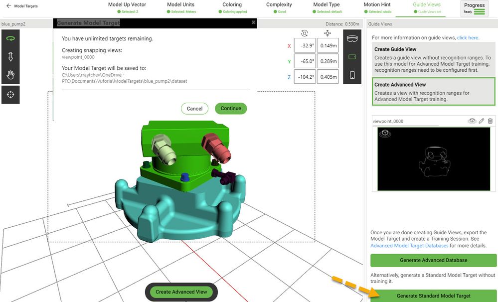

2.) how to use the multi model Targets?
  2.1) the first point is how to generate the model Target.  We can use the Model Target Generator tool to generate Model Targets . The model Targets are then saved as <modeltargetName>.dat and   <modeltargetName>.xml files . We can save these targets in a subfolder of the Upload project folder and try to used them later in the project. I tested with Standard guided views.

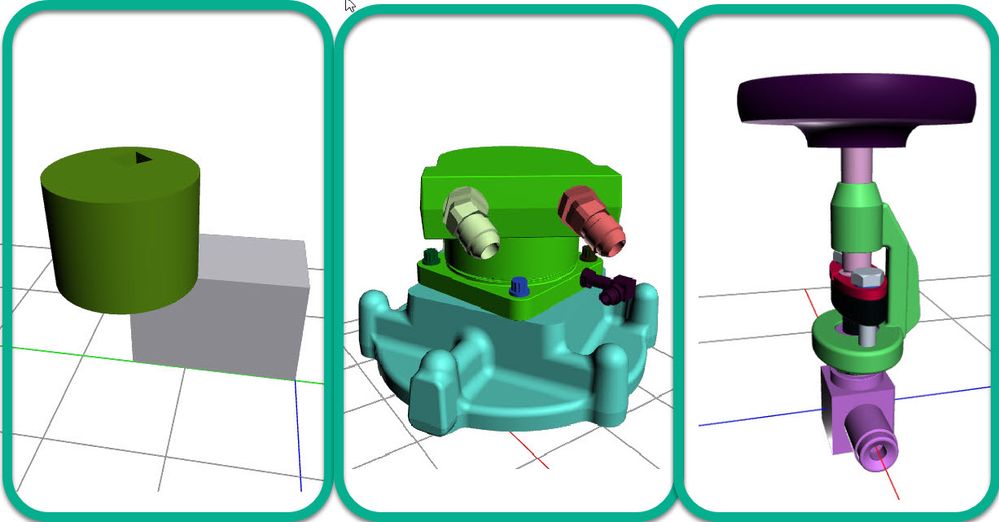

To test the issue I create an simple project with the following 3 Targets generated by the Model Target Generator
In this case I use for the tmlText an array which contains only one item /target and the target is set before entering the view via application parameter. The tml Text is defined as
