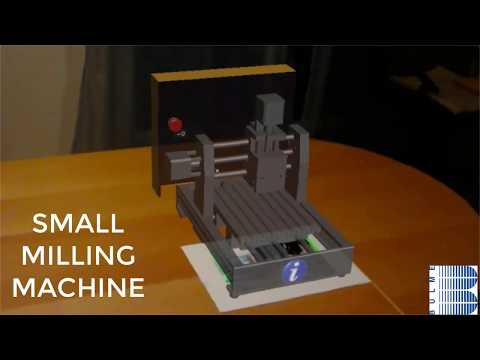

Trying to figure out a way of displaying .pdf files in a AR-experience using Hololens. To do it with a smart phone/ tablet works fine since you cna work with the 2D-canvas.
However it becomes trickier when using Hololens. Ideally I would like it to work something like this:
https://www.youtube.com/watch?v=JrZUXxcfaA8
In this video different information popups apear, however I think this is 3D-image widgets which I'm able to create. But would be better to actually try to import a .pdf file and make it apear as a popup like the images.
Is there anyway to that?
