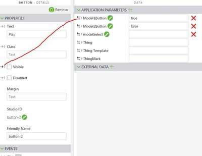

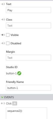

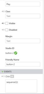

  • Drag and drop 2 button widgets on to the 2D canvas.
  • In both the Button properties:
    • UnCheck the Visible property .
    • Click on JS next to click event and call the functions as shown below:
  • In the Data panel, add 2 application parameters. For example, add Model1Button and set it's value to true and add Model2Button and set it's value to false.
  • Drag the binding icon infront of Model1Button and drop it on the visible propert of Button 1.
  • Similarly, drag the binding icon infront of Model2Button and drop it on the visible propert of Button 2.
