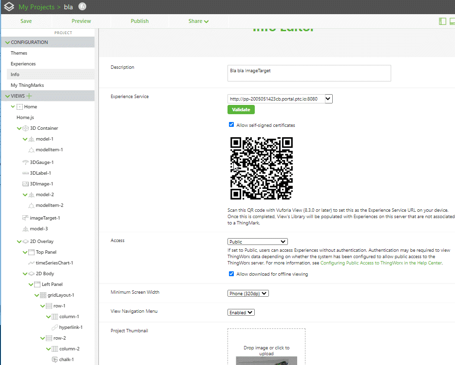

Hi everyone.
I found this article : https://www.ptc.com/en/support/article/CS284529 that explain how to access to Vuforia Studio Preview mode from any mobile browser.
I tried the procedure (https://%3Cexperience-server%3E/ExperienceService/content/projects/%3cproject-name%3e/index-desktop.html?expIndex=0#/Home), enabling "enable debug logging" and adding into "builder-settings.json" the string ""publishPreview": true" but accessing with the link that point to my experience service doesn't work.
I tried all that is reported into this discussion: https://community.ptc.com/t5/Vuforia-Studio/Vuforia-Studio-Preview-in-Mashup/td-p/609433?source=ArticleViewerRelated
Anyone has some ideas on how to fix this issue?
Hi @leonardosella
it seems that there is some issue what are not documented completely in the mentioned article https://www.ptc.com/en/support/article/CS284529 .
Of course the settings mentioned in the article for  the project are required but there are some issues with Holographic projects / HoloLens project where  seems it could not be displayed. I think this need to be checked more deeply why in one case is working and on other case is not working.
I think the project should be published as public and should contains at least 2D canvas widget / but not sure. Or it depends if the mentioned setting in the article are set on project creations… need to be checked more detailed
So e.g. if you check the link:
http://pp-2005051423cb.portal.ptc.io:8080/ExperienceService/content/projects/bla/index-desktop.html?expIndex=0#/Home
This work the link is created as mobile and public:
