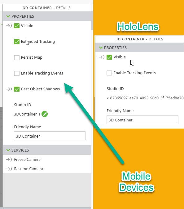

Could I get some more information on these two options for the 3D container?
https://support.ptc.com/help/vuforia/studio/en/index.html#page/Studio_Help_Center/Widget3DContainer.html
This article only mentions ThingMarks, do these options also affect model targets? We're having trouble where our experience loses tracking once the model target is even slightly obscured from the camera view.
What combination of these options would solve these tracking issues?

When we consider the 3d Conatiner widget property we can observe a difference between the HoloLens and mobile device:
So,we can see that the is properties are only available to set to the mobile devices. On HoloLens this options are always used - the HoloLens created always persistent map on the environment and used Extended tracking.
Extended Tracking is quite useful when the Target (e.g. Thingmark) itself will not move with respect to the rest of the environment. Vuforia will use the surroundings of the ThingMark to "remember" where the ThingMark is, even if it is not on camera. This is also for other kind of Targets when the devices itself has an AR support and it is able to generate a map on the environment outside the target. So means in this case you  have to move slow many time the device to scan the environment so the device could generate a persistent map- means you can move away the device and when you return back  and scan again the  location (where you generated already a map) it will remember the position - so without viewing the target itself
But if the mobile device does not support the generation of persistent map – the setting will not have any effect

Ok, I misunderstood it - now is clear - you want to lock the position - also when you do not see the model target in the camera. And this is what we can expect form  the Mobile  3d Container widget features  "Extended Tracking" and creation of Persist Map"
As I already mention in the previous post the viability of  Extend Tracking (remembering the rotation, translation of the camera when the target is not in the camera area and the  more advance feature -> the creation of persistent map which means that the surrounding geometry is mapped and it will calculate the position of the 3d geometry without to have direct reference to the target.
How good the tracking is working depends highly from the used device and its support for AR. Some devices without AR support will not provide this functionality – means that setting of the options in the 3D container will have less or no effect.
E.g. the best Job for extended tracking  and persistent map will do the HoloLens. There the option in Studio are not available because it is default and could not be disabled
For the mobile devices as mention it depends on the AR feature they supports.
I tested  a simple project with 2 models where the one small part was used for model target.
I tested with 2 devices IOS iPad 6 generation - this device has better AR feature .
As second, I tested with Android Samsung Galaxy 9+ but there it was also working fine.
I tested with deactivated “ Persistent Map” only Extended Tracking and this was also working – means the tracking was not lost when I do not see the target.
Then tried using persistent map. So first when I scanned the model target , I also sanded the environment - so that the device could create a map for the environment  and will make the tracking more  stable (persistent map was activated). The persistent map requires that your environment contains a geometry which could be used as references (e.g. lines and edges with high contrast  - no reflex surface e.g. mirrors or class etc.)
I tested e.g. on Android and move around 10 meter form the target in opposite direction and then return to the target without scanning the target – the tracking was not lost and the model was as desired locked to its position.
