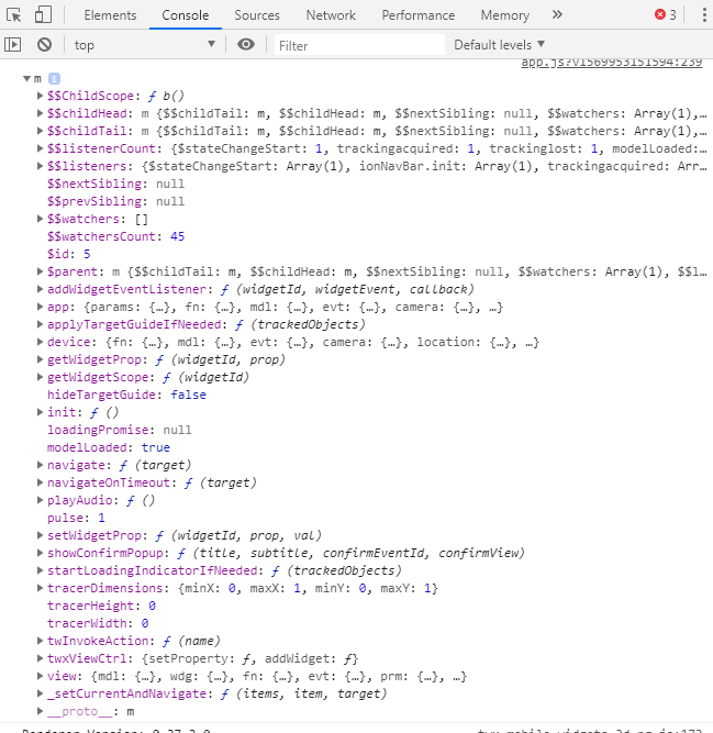

For finding the possible services/events, try exploring the $scope object within the browser console window. You can navigate through the object within the console by adding console.log($scope); to your Home.js file.
