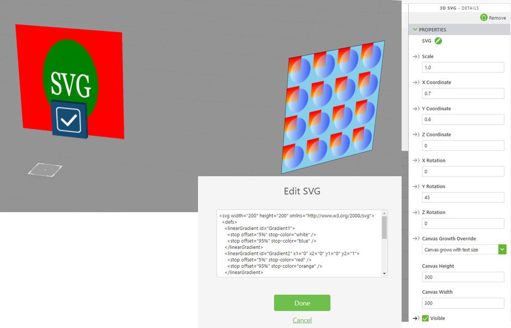

I tested it and I have the same problems reproduced, so it seems that there are many issues. So I tried to check the extension from OCTO GitHub Progress-3D widget  , what you mentioned that was taken as start template for your  widget and it was not working  in eyewear project. when I tested - possibly the version or some specific setting is required .. no idea
I checked if there is other source with simple 3D extension and think this one is simple and work fine ->open source Extensions  for Vuforia Studio at GitHub repository
In this github repository there are several 3D extensions defined which does not use to much code but are relative simple. - e.g. tmlSVG see also
I think this extension uses some 3Dproperty as template and how it is designed make e.g. for me more easy to understand and customize it later - TMLSVG.design.js and 3dsvg.js
attached here the project where I tested this extension.

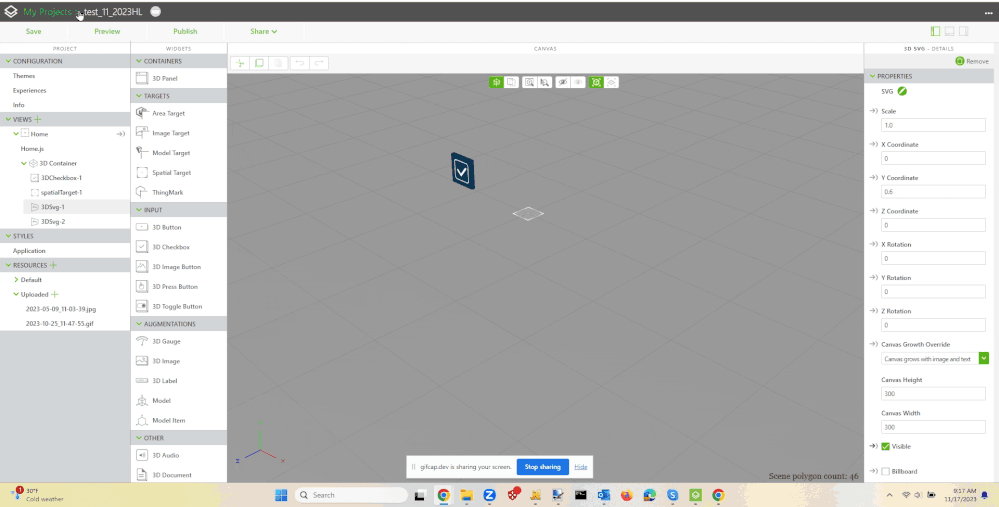

Hi Roland--
Do those SVG extensions work for you, especially using the dragger to move them and see the location parameters update? They don't work for me--I get the same errors with these that I am getting with my own extension. The dragger controls *seem* to work, but they don't actually update the location parameters. I tested with my own (new) experience and also the one you posted above.
