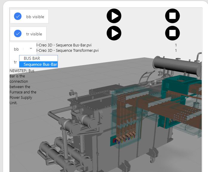

I want to add following feature in my experience.
1) Hide/Show pvz real time
can you share the javscript with example.
Thank you

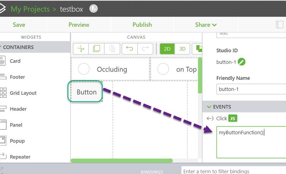

So simple hide and show a pvz , you can do this simple by binding of the checkbox to the visible property of the model widget and this will also hide or show the model widget in real time. So, the question is what does mean here "real time "?
E.g. in the post I mentioned a javaScript code which more simplified could be packed into a function and then you can call this function form a button. Here it will hide the widget e.g. model-1 . It is possible to hide also a modelItem- means awidget which is a  component of the model widget.
$scope.myButtonFunction= function () {
$scope.$applyAsync(()=>{$scope.setWidgetProp('model-1', 'visbile', false); });
Then the function could be called form a button when you add the function   call to the click event  property:

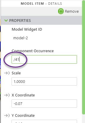

another way ->you can try to set directly the modelItem without modelItem explicit widget definition is some call like this:
$timeout(function() {
      tml3dRenderer.setProperties('model-1-/41', { hidden:true } );
       },500)
where 'model-1' is the widget name of the model widget and /41 is the ModelItem widget occurrence path

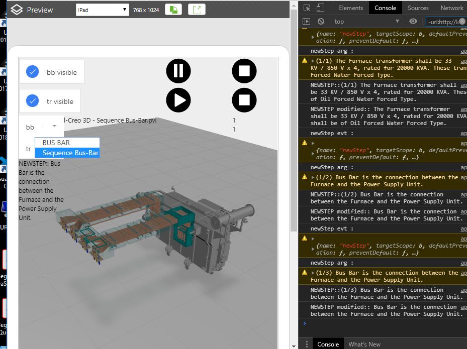

Hi @nraichura ,
using some code like this you can call for a model widget a specific sequence/figure and to call a step number - saying play = true - means to play it or only to set the current step without playing it.
////////////////////////////////// Here add this part for the last question from 11.04.2020
//definition of the function
$scope.app.playModelStep = function (sequence,modelName,step_number,play) {
 //sequnece -sequnece name e.g. TestFigure1 - as shown in UI
//modelName - model name e.g. model-1 widget
//step_number - set this number to current step
//play   true/false execute play for the model
   $timeout(function () {
  $scope.$applyAsync(()=>{$scope.setWidgetProp(modelName, 'sequence',  '');});
  },50);
  $scope.$applyAsync(()=>{$scope.setWidgetProp(modelName, 'sequence',  'resources/Uploaded/'+sequence);});
  },50);
  $scope.$applyAsync(()=>{$scope.setWidgetProp(modelName, 'currentStep', parseInt(step_number));});
 if(play)   //check if play should be applyed
 $timeout(function () {angular.element(document.getElementById(modelName)).scope().play();  }, 100)
   //angular.element(document.getElementById(modelName)).scope().play(); }, 100);
           , 500);
 This above is a general function when I want to do some call. The requirements is that I have this information - the modelwidget name, the figure/sequence name and the step number.
I changed the example to demonstrate  how to get this information from model widget List property
I attached the modifed project to  this post- so hope it could help.

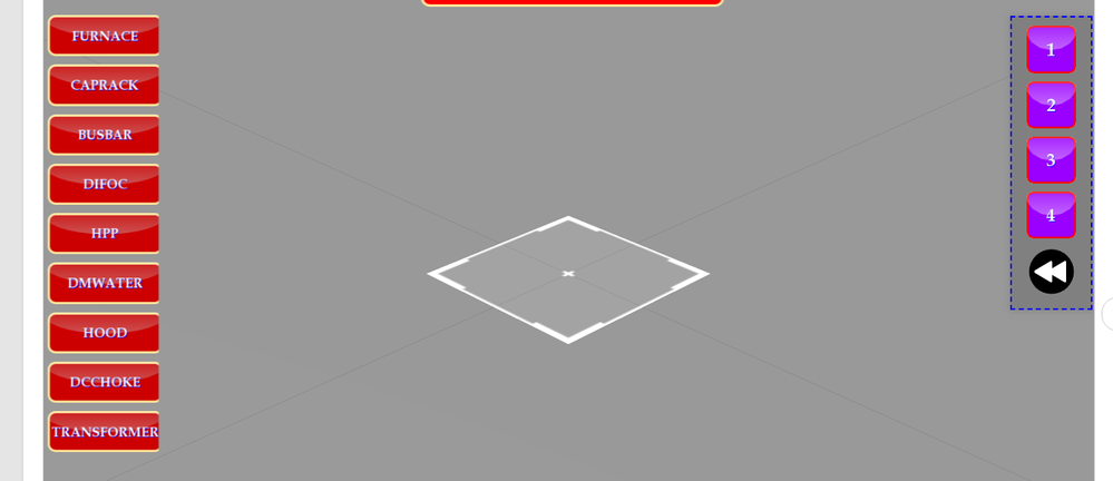

Hi @RolandRaytchev
I have attached my project link as i want to achieve following functionality.
https://drive.google.com/open?id=1Is1LEnTOlFyDNZpQAQOTJYDNWE3pqQbU
When Checkbox of Furnace is true all button should visible for the figure which is inside the pvz.
Following are the figure that should play once the button is pressed or click.
So conclusion is
1) Check box of Furnace should true
2) During that sub sequence button can be seen
3) Sub sequence should be play through individual button and once check box of furnace is off all button and model should hide .
Here pvz file size is too heavy because could not able optimize during upload if you can able to optimize than it will be very useful for me.
Thank you
