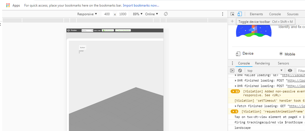

Now I have the problem that screenorientation is always landscape-primary. I tested it in chrome with the preview function and changed the orientation by clicking the change orientation button at the top of the preview site. Every time I change the orientation a changeorientation event is released, but it always says landscape. Is this function not possible at the preview?
Greetings
sdidier
(To:mn1)
I have the same problem in Preview in Chrome.
To avoid that, i have followed these steps :
  1. In Preview, on keyboard, press F12 key
  2. In Developper Tools, click the Toggle device toolbar iconChrome_toggle_device_toolbar.png
  3. Choose a device
  4. On the right, change height and width
  5. Orientation is modified
Best regards,
Samuel
