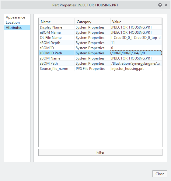

On the subject of modelItems, if you don't want to enumerate part levels in Creo View, you can open the model in Creo Illustrate and use the part properties->Attributes view to find the sBOM path:

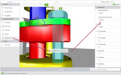

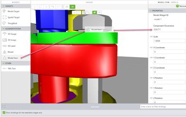

I think the similar  functionality , if we   suppose  that you do not have knowledge about  the model and have no idea about the ids in Creo View or Illustrate so  in this case you can also find the ids in design mode when you drag the model item widget of an component.
So the component occurrence shows the ids of the component. Here on the picture for example 0/0/7/1 - is a part "slice" which is inside an assembly "bolt_cmp1".

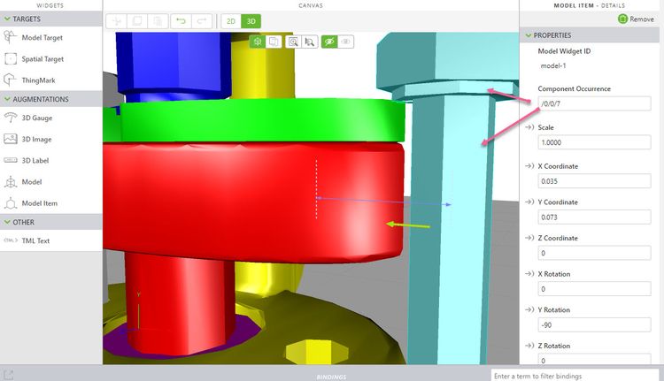

If you want to use a level above, means  - if it is a part and you want to have the modelitem of the assembly  you can edit the component occurrence value to /0/0/7 - in this case the modelitem refers to the assembly.
This could be done temporary so that when the model items widget is not required any more it could be simple removed

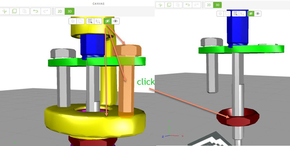

Sometimes it will be difficult to click the correct modelitem, because there are many components overlapping. In this case , you can modify the number by trial  and error and check the display if you catches the correct item or you can hide a component/components to be able to click the desired component
