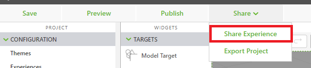

To do this I use QR codes for the experiences.
Once you have published the experience, go to the Share, Share Experience option:
When the dialog box comes up, click on Copy Link to copy the URL to the clipboard.  Note that the link will only be available if an experience has been published:
Go to an online QR code generator (just Goggle QR code generator) and past the URL to generate a QR code.
Then you can email the QR to someone to view the experience without having to let them see the entire library.  You don't even need to print out the QR code, it can just be scanned off the screen inside the View app.
If they want to be able to view the experience without needing the QR code, they can bookmark the experience once they have loaded it for the first time.
