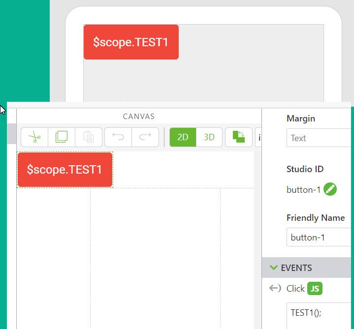

Hi @IB_10645210 ,
lets suppose that we have:
1.) Vuforia Studio Project "A" where in a any View there is button which should call:
2.) Experience "B" - which have e.g. Home as start view and also the Views TEST1, TEST2 and TEST3  etc
and we want that we have to specify in the call that view TEST2 in B is called.
I think is possible
In project A we have to define the function:
//url of the deepLink of Project B
$scope.UriTest='https%3A%2F%2Fmrerot7o.studio-trial.thingworx.io%2FExperienceService%2Fcontent%2Fprojects%2Fdynmodelchangeuicommunity%2Findex.html%3FexpId%3D1'
// the view of the proejct B which should be called
$scope.cVIEW="TEST2"
// this the function what should be called by the button
//it will call project B (specified by url - and then call view
$scope.callViewProject=function(url,view){
window.location.href='vuforiaview://ptc.com/command/view-experience?url='+url+'%3FVIEW%3D'+view
$scope.TEST1=()=> {
$scope.callViewProject($scope.UriTest,$scope.cVIEW)
This should be the call from Project A to B where we pass also as parameter the View which should be called here 'TEST2

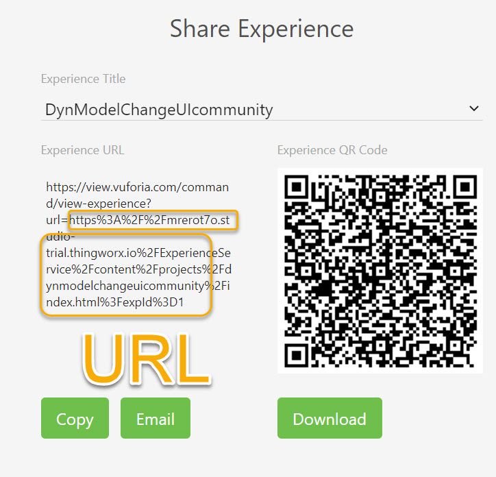

E.g. the URL we can take from the deep Link  of "B" in the Share Tab Share Experience
So that is the part what we need to call from project A to call B->TEST2
