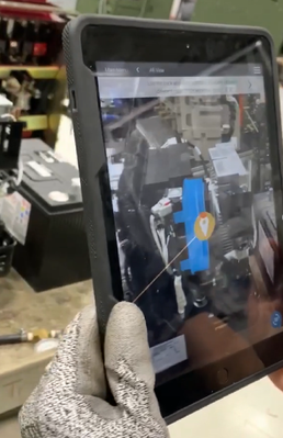

How to use the hardware Up and Down Volume buttons in an iPad (OS13) as Prev and Next buttons using JS or AngularJS only?
Any ideas welcome!
Note: users wear gloves all the time so removing gloves just to click the UI Next/Prev buttons on the screen defeats the purpose or if the use their globes they damage the screen (HoloLens are not affordable yet 😞 )
