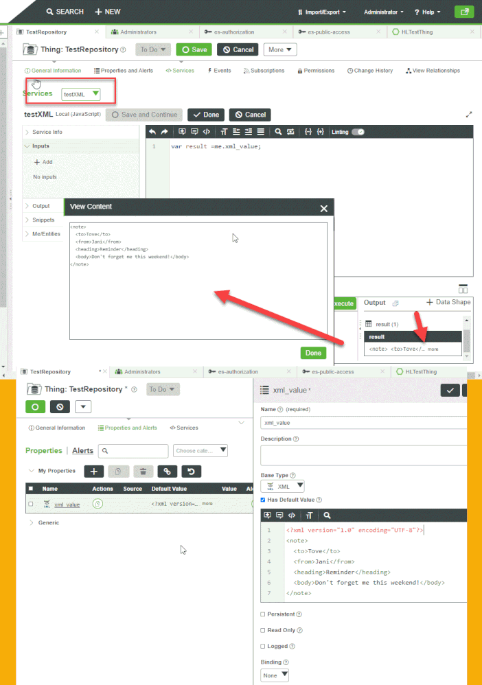

I am not sure what is the exact goal in your application case.
So far you can pass a xml file (or any files) from a Thingworx repository witht the methods Load XML but also LoadJSON (json) LoadText (ascii chars), LoadImage (pictures) and LoadBinary (for any file format)
So this means if you have e.g. an xml file in a Thingworx repository you can sent it to Vuforia Studio and received it into memory variable.
When the data is not in repository you can:
- save the data first there e.g. for xml format SaveXML (mehtod of a Thing which is inheriting the FileRepository Template) or SaveBinary (for any file format ... also xml)
Another option to define your own service which output xml - e.g. picture below:
So we can see that there are some options to sent the xml data to vuforia Studio - it will be received in the ServiceName-complete event --> example:
We can see that there are some options to sent the xml data to Vuforia Studio - the xml data will be received in the ServiceName-complete event --> example:
$scope.$root.$on('LoadXML-complete', function(event, args) {
console.log("$scope.$root.$on('LoadXML-complete'");
console.warn(args);
here the args will contains the whole xml file string. So, you can use any XML parse techniques to find the correct tags. e.g.:
