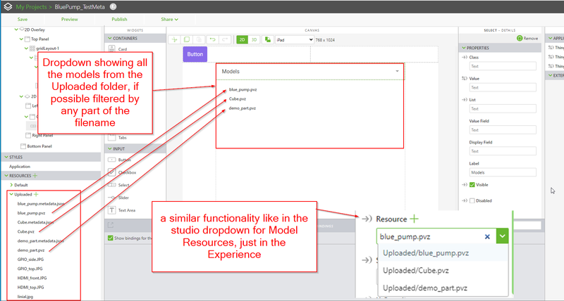

Hi community
I have a advanced question.
Is it possible to populate a list with parts from the Uploaded folder? The Model Resources selection in Studio does the same thing. But I want the View user to be able to do it, without having to hardcode the model names in JS. If we could filter the models by some part of their name, that would be even better.
Thank you for your help!
Best wishes
Alex
Hi @AlexK ,
so far I know this list is  a static list . During the Vuforia View session you can not add any files to the Vuforia Studio Project folder(loaded already in the view app) So that when you have a list in Vuforia Studio it will not change during the view session

 In my case I used this list for some automatic play in the background and not to display it. But I think the same approach could be used also to display the list e.g. in select widget. This was my workflow but possibly there could be a better solution and somebody could share it here. Thanks
