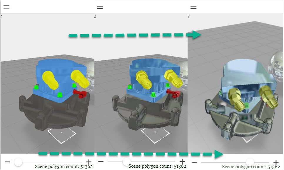

But you can try to use some shader ... e.g. the reflect shader and try to get some shining effect when you use images/pictures as texture which have more bright
