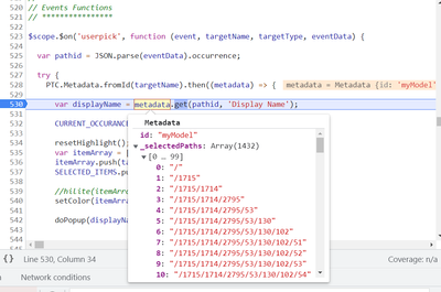

I want to navigate the metadata JSON file as I do with regular JSON files like the example below
myjson["/0/1/0"]["InnerField1"]["DetailExample"]
but I want to do this with metadata Vuforia API. How to?

Once you have executed say for example PTC.Metadata.fromId  as shown below you can use just like standard json but the functions provided in the link by @pandersson might be easier
$scope.$on('userpick', function (event, targetName, targetType, eventData) {
var pathid = JSON.parse(eventData).occurrence;
try {
PTC.Metadata.fromId(targetName).then((metadata) => {
var displayName = metadata.get(pathid, 'Display Name');
CURRENT_OCCURANCE = pathid;
resetHighlight();
var itemArray = [];
itemArray.push(targetName+'-'+pathid);
SELECTED_ITEMS.push(targetName + '-' + pathid);
//hilite(itemArray,true);
setColor(itemArray, HIGHLIGHT_COLOR);
doPopup(displayName, pathid);
} catch (err) {
console.log(err);
