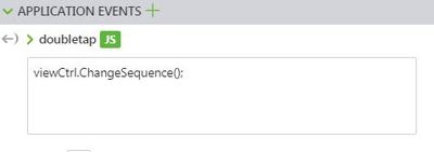

A workaround to play multiple sequences is - extract the .pvi files and upload them separately on to the project. Once uploaded, use the resource path to activate the requested sequence:
$scope.view.wdg['model-1']['sequence'] = 'app/resources/Uploaded/l-Creo 3D - ... .pvi';
Here is the sample JavaScript function for the same:
$scope.ChangeSequence = function(seq_name)
$scope.view.wdg['model-1']['sequence'] = 'app/resources/Uploaded/l-Creo 3D - ElbowMotorReplacement.pvi';
$timeout(function() {
$scope.$broadcast('app.view["Home"].wdg["model-1"].svc.playAll');
$scope.$applyAsync()
, 2000);
You would have to write separate functions for each sequence and link them in the Application Events as shown above.
Hope this helps!
