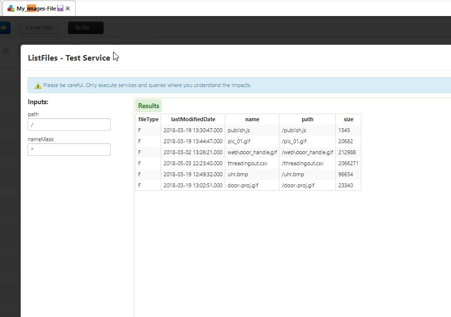

2.) How to get files from repository- I think it is possible and you can get a  image file form repository via the LoadImage service.

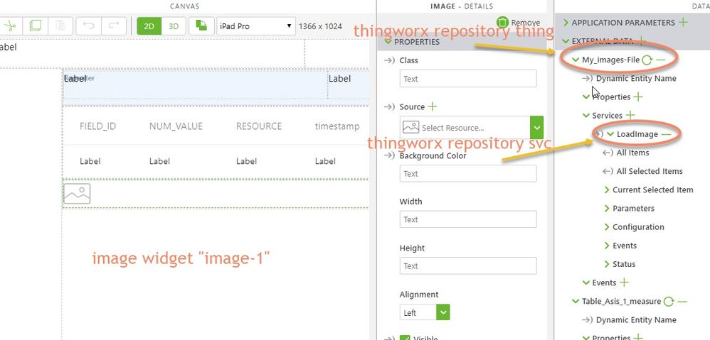

Now tested and  it was working. So have an project with a 2d image widget with the name/ id "image-1".
Also I have a Thingworx repository thing with the name "My_image-File":
In the external data added the TWX repository and the service LoadImage.

This will display the image form the repository in to the image widget:

I think for formats where we do not have the special service (json, text image) we could use instead the general binary service of the file repository thing  - SaveBinary / and LoadBinary to save or load any other file formats (e.g.  pdf)
So with such service you can load the pdf file but ... you cannot set to the source of the Image to display it and need to check more detailed the point 1.) what I mention in my previous post
