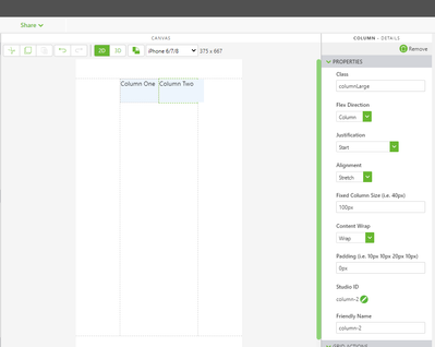

I'm trying to set the width of some columns from the css. Is this not possible or does it require different syntax than normal css? I've tried column-width: 30px and width: 30px but neither seems to have an effect.

In Vuforia Studio, in Grid Widget, in Column property panel, we can see the Fixed Column Size field.
In Preview, when running, in Developer Tools, we can see that these CSS settings are used to manage the size linked to this field :
I would recommand to use these Properties in CSS style sheet.
  • Is it helping you ?
