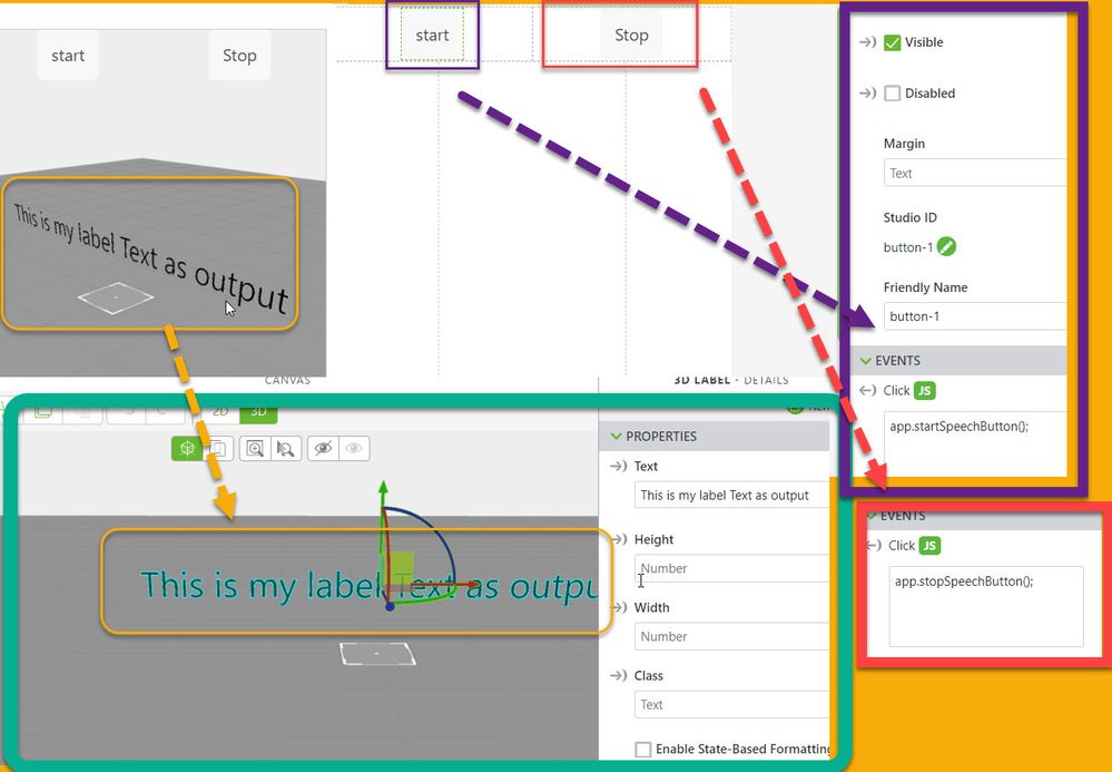

Used a simple project with 2 buttons and 3Dlabel widgets:
The voice output of the text is working fine on all Preview, IOS and Android devices.
But the stop/ interrupting the spoken Text was possible only on Preivew mode and IOS. For me was not possible to stop the text on Android mode. I posted this issue to internal dev community - so I hope that there we could get some hints
