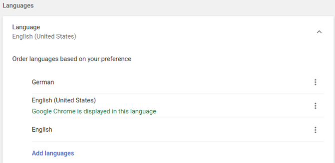

after the new update (8.2.1.2937) the language is set to the windows language (german in my case).
I want to change it back to english. There is no possibility to do this in the options.
Someone know where to change it?

Studio uses the language set in the browser. The top language in the list will be what Studio uses. After making the change, a refresh of the page is required. With the below settings, I am seeing German in my Studio environment. Adding English to the top of your list should change it back for you.
