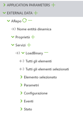

I'm trying this solution, but something doesn't work. I set up the load binary service from VF studio.
my repository is called ARepo and i changed the related parameters in your code. Can you find some mistakes?

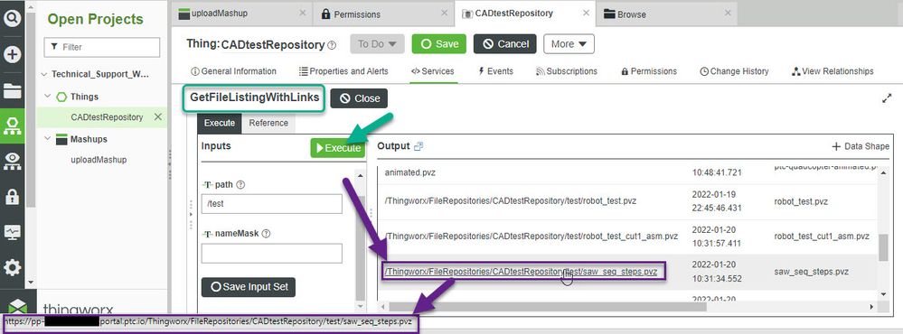

Hi @GianVal ,
for example if you look in  the report e.g. in Thingworx you will see (as mentioned in your comment) here example for my environment :
/Thingworx/FileRepositories/CADtestRepository/test/blue_pump.pvz'
/Thingworx/FileRepositories/CADtestRepository/test/Illustrate-Annot_Brake-Explode.pvz
but if you click for example the link in the TWX UI  it  will also contain the TWX server - and should be :
 https://pp-XXXXXXXXXXX.portal.ptc.io/Thingworx/FileRepositories/CADtestRepository/test/blue_pump.pvz'
https://pp-XXXXXXXXXX.portal.ptc.io/Thingworx/FileRepositories/CADtestRepository/test/Illustrate-Annot_Brake-Explode.pvz
where https://pp-XXXXXXXXXXX.portal.ptc.io is here my  TWX server (ok some letter replaced by XXXX)
So means that you link requires also the Server URL s.e. https://yourServerURL//Thingworx/FileRepositories/ARepo/resource.pvz
You can see this url when you go to the service in your repository thing (GetFileListingWithLinks) and execute this service  for  particular folder. Then click on link and see the value in the browser

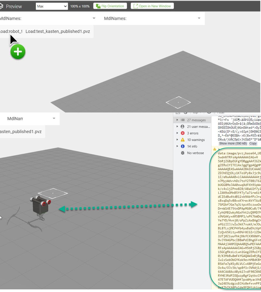

I found a way to make it work. was an "async" js problem. anyway I can view the binary text the same as yours but I'm getting this error
"Error setting model URL on [model-1] due to [{}]"

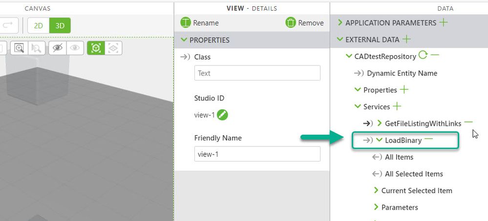

Hi @GianVal ,
I do not know this error- so believe possibly some syntax in the generated string. Does this issue occur on mobile device or also in preview mode?
I checked the project and used following code - simplified version:
  1.  to start the service
