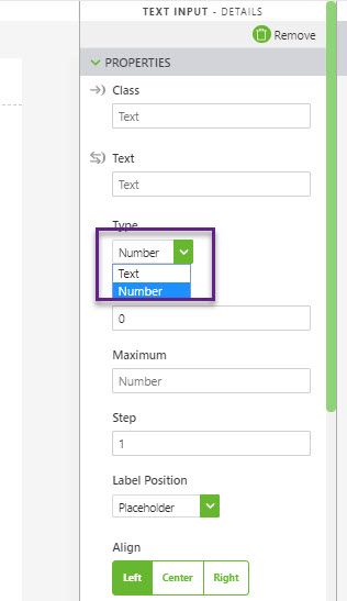

Hi @PhilipB ,
I think NaN means that value is undefined, and you can check first the value if it is undefined.
You can see e.g. this post (How to check a not-defined variable in JavaScript)
but I think , when I look on your code - is the quesiton what should haepend when you try to multiply some undefined things. May be some exception should be thrown and you can catch it in this case.
May be in this case you can check fist the text value of the input widget / what this  string contains : if it is numeric and could be parse to a number e.g. parseInt(), parseFload or Number() or is only string and you need to use any sting operations.
For Input widgets you can specify the type as Number with max and minimum value - so this will ensure that value could not be any other text.
thanks for answer, tested that functionality as well but didn't really work well. It worked in preview and limited in such a way so only numbers could be written in the text field, but when publishing and used in phone it didn't work well.
Have asked around and searched the web and eventually ended up with this code that worked:
