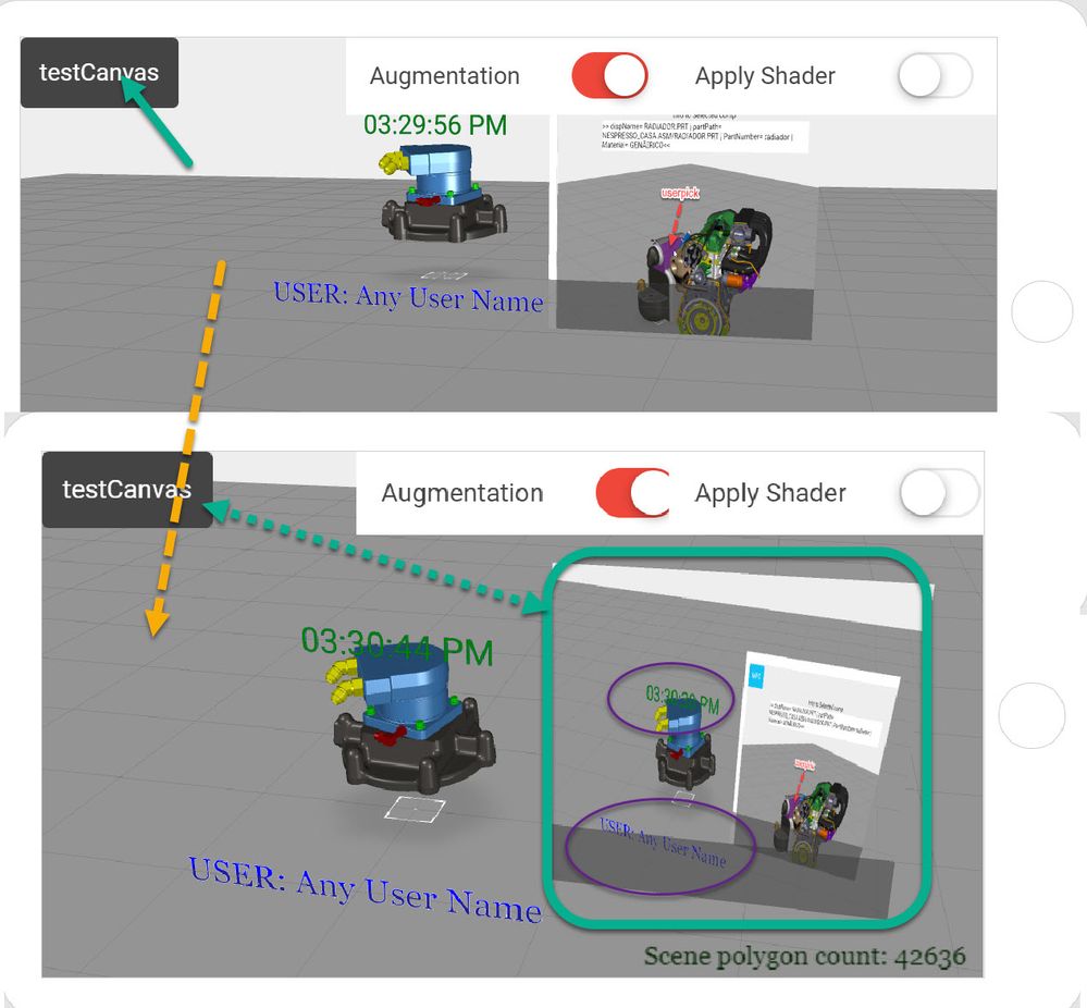

1.) currently you can capture , so far I know,  only the screen with 3d augmentations. This could be done  with some code like this:

This function will create a snapshot of the device screen and will set the picture src - property  of the 3DImage Widget - to display the picture in the project. In your case you need to save this picture to TWX , point 2 below.
The Augmentation parameter is true then it will capture also information of the 3D augmentations , if false only the picture of the camera. Please, pay attention that it could not capture the 2D augmentations. So that means that whole information (Augmentations, 3dModels, inputs, user name etc.)  you need to capture should be displayed on 3D Widget e.g. 3D Image, Labels ,model gauges, Example:

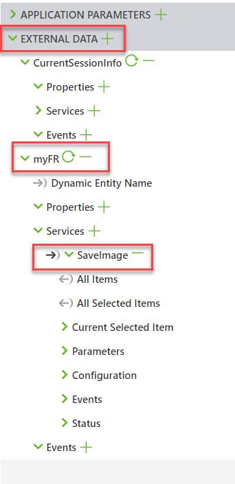

2.) regarding to the user name - and other information you want to save to Thingworx -> So to save a picture to TWX repository you can use SaveImage service of the repository to save the picture. You have to add the service of the Thing repository where you want to save e.g. myFR
and use some js code like this:

$scope.SaveImageToTwxRepository = function(path, content) {
 $scope.$applyAsync(function() {
     $scope.app.runMyTWXService ('myFR','SaveImage',{"content": content, "path":path} )
               }   ,500 );
  console.log( "Called -$scope.SaveImageToTwxRepository");
Here the picture is taken from  a camera widget - image property but you can use any sorce - e.g. the sourc of 3DImage widget in 1.)
Regarding to get the information about user or user group - you can use the Thingworx methods :
CurrentSessionInfo.GetCurrentUser()
CurrentSessionInfo.GetCurrentUserGroups()
