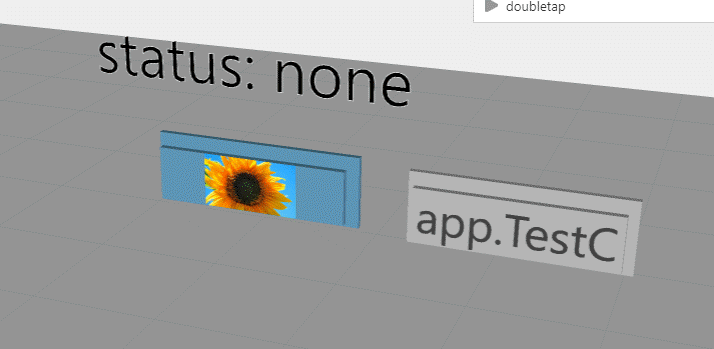

$scope.app.button1Click=function()
console.warn($scope);
$scope.app.my_speak("You clicked the sunflower button");
so when I tested it, it printed the message in all possible voices and also displayed   info about the spoken language name

$scope.app.TestC = function() {
 var msg_text="this is my message!"
 var languageNameContains='English Male' // this is vor preview mode /chrome
 if(twx.app.isPreview() != true) languageNameContains='George' // for the HL 2 I want to have George as speaker

} //finsi app.TestC()
The  mentioned code will work on both - HoloLens 2 and chrome calling depending on the env one of the available voice.
To call this code use the 2 button "app.TestC".  You can call the Flower button to see all availble voices on The HoloLens 2, so you can later choose one voice which you want to use for the messages
