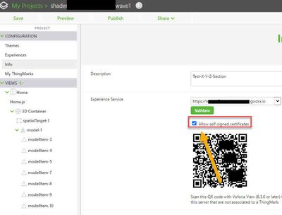

I will understand that the issue is this:
2021-10-27 18:16:32.268 ThingBrowser[280:5007] Error : [Error Domain=IRSQueryErrorDomain Code=0 "(null)" UserInfo={httpStatusCode=0, NSUnderlyingError=0x28080a9a0 {Error Domain=NSURLErrorDomain Code=-1202 "The certificate for this server is invalid. You might be connecting to a server that is pretending to be “192.168.44.16” which could put your confidential information at risk." UserInfo={NSLocalizedRecoverySuggestion=Would you like to connect to the server anyway?, _kCFStreamErrorDomainKey=3, NSErrorPeerCertificateChainKey=(
So far I see this is https server with self signed ceritficate , right?
Could you check, please,  if the option use self signed certificate is set?
DT
6-Contributor
6-Contributor
(To:RolandRaytchev)
Yes, the self signed is checked ..

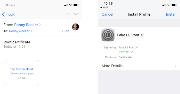

when you Experience Service is installed as https - in tis case I believe the following links could be helpful :
https://www.ptc.com/en/support/article/CS301678
https://community.ptc.com/t5/Vuforia-Studio/Unable-to-connect-to-Experience-Service-HTTPS-protocol-with/m-p/673462?source=ArticleViewerRelated#M8435
https://gist.github.com/Soarez/9688998
Please, let me know if you could not access the link or if this info was not helpful
DT
6-Contributor
6-Contributor
(To:RolandRaytchev)
Hi Roland,
i have try to generate the CA but it is not successful .. From the information above, Im not quite understand how to generate the CA or Edit the CA..
Is that any other link to learn how to generate a CA ?
i have some update and there is a keystore jks key (Attach the Picture), but there is no Trust certificate in it. From the Keystore, I managed to export a "PKCS12" into android mobile .. Now the Mobile log file show a different error log (Trust anchor for certification path not found) and the link Https:  change to HTTPS (Attach the Picture)  ..
