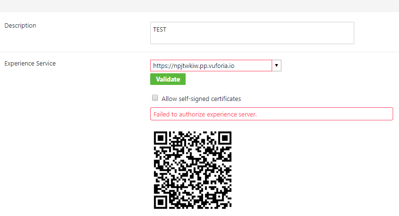

I cannot ping 10.76.68.192.
In your second screenshot, it is strange to have the error message Failed to authorize experience service.

Q:What happens when clicking in the Validate button?
A: About 10 seconds, I got the results like this picture.

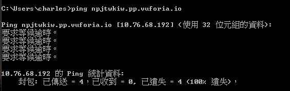

Q:What happens when pinging this server npjtwkiw.pp.vuforia.io ?
A: I cannot ping this website. 100% lost......

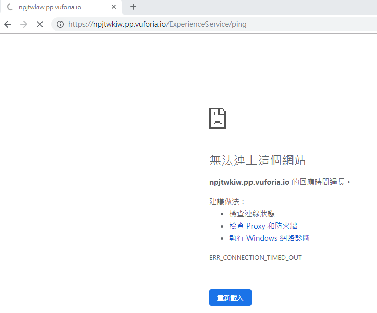

Q: In a Web Browser, what is the result of this URL https://npjtwkiw.pp.vuforia.io/ExperienceService/ping ?
A: I just got an error message!!!
Thank you for your help!
It seems the server who hosts Vuforia Experience Service is not running at all or it is not reachable.
  • Can you access to it physically to check if it is running ?
Best regards,
Samuel

Hello, Samuel,
The server hosts Vuforia Experience Service is not running at all.
So I cannot use it.
