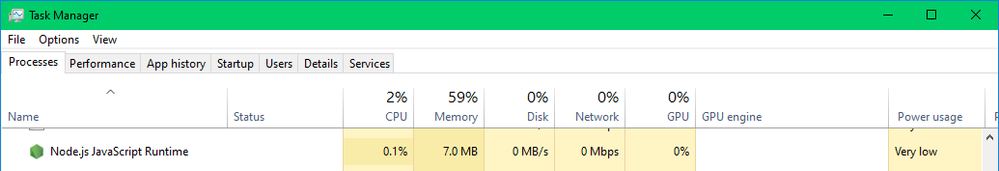

hi @EB_9898800 can you share your Studio log files to help troubleshoot this further? One thing to check is that there are no other node.js processes running on your machine.

Can you verify that you don't have any other "Node.js" processes running on your machine?

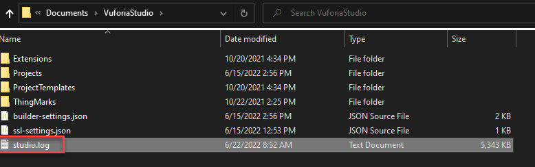

You can also try grabbing the log file manually from the VuforiaStudio directory:
This file will help to determine root cause of the issue.

Good morning, I have verified it, I do not have any Node.js process or service running

I have also tried to open it directly and it does not let me open the log file
