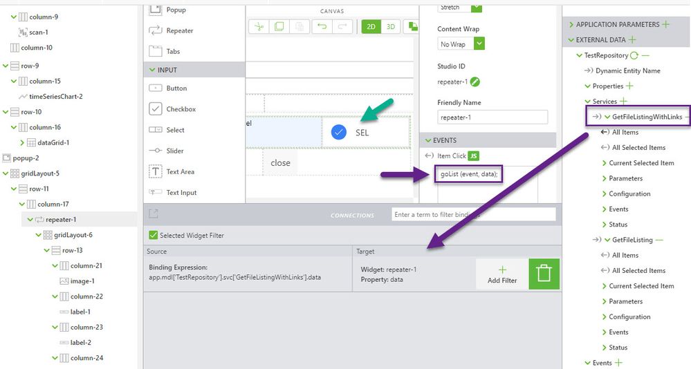

My idea is to track the ItemClick event. The data what I printed in the test function goList was to show that I could deside/ check for which data set was the ItemClick event called . Here in my example it was called for the dataset where the path is /image/door_type_c.gif
Then I check the property _isSelected or better to say it will be checked by my service where I say- now on the ItemClick event was called for dataSet where path /image/door_type_c.gif and have a value _isSeleted –(depending on the setting it could be true or false and could be in the event changed or it was a click without change/ This is for me not first not relevant and I will pass it back to Thingworx via my service mySelect where I pass one key/database key/ to identify which data Set in the thingworx table I did currently selected and the value of the checkbox widget to update it to the value in the database. The update is done by method. My concept was using a directly display of the repository and wrote the data by single records to another table

In the repeater Widget I used the event 'Item Click' where we could receive the current data of the selected row /selected data set / e.g. :
Using function arguments we can find the current data and the current selection which was done. In this case we can call a Thingworx service to update the value without sending the whole data as update action but only to update in a single action the value for each data set onchange -. e.g. javaScript code for 'Item Click' event could be some thing like this:
$scope.goList = function(event, data) {
console.log('event.targetScope.me.widgetName='+ event.targetScope.me.widgetName)
console.log('data.name='+ data.name)
console.log('data.path='+ data.path)
console.log('data.size='+ data.size)
console.log('data._isSelected='+ data._isSelected)
let TWXmodelID = 'TestRepository';
let serviceName = 'mySelect';
let parameters = {'SELECTED': data._isSelected, 'LINK': data.path};
twx.app.fn.triggerDataService(TWXmodelID, serviceName, parameters);

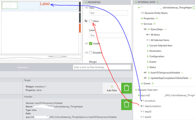

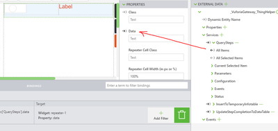

Thank you for your detailed answer! I tried to follow what you suggest. I bind the All Items from my service to the repeater. You can see the image below.
Inside the repeater I have 2 columns, first column is checkbox widget and second column is label.
I also follow your step to put javascript when the user clicks the repeater.
In Home.js , I also put the script to log the data.
I bind the data.stepCompletion from repeater to the checkbox and data.procedure to the label.

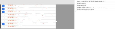

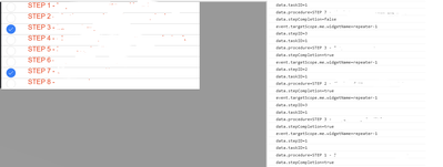

There are 8 steps and this is initial data from database.
But when I clicked on any steps, it doesn't show the desired value. For instance I click on step 7, it will show false.
Seems like it shows the initial value from database. Because when I click on step 1-3, it says true, no matter what the real value is.
I have created the service to update data per row and it works. But the problem is I can't get the updated value since the data always show the initial value. Did I miss something?
