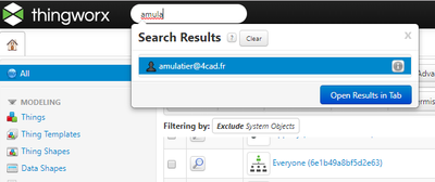

For me, changing the password can be an issue beetween Vuforia Studio and Thingworx Composer. Can you go there : https://twx.studio-trial.vuforia.io/Thingworx/Composer/index.html with your url from the trial ? And check the credentials?
I followed the link you sent and can login with my trial username and password no problem. Not sure what you mean by checking credentials ?
Do you find your mail ? Check the password and try to change it inside of Composer
It will not let me change the password .. the error message is ..
Error changing password: Unable to Invoke Service ChangePassword on roger.thomas@sunderland.ac.uk : For input string: ""
Update; on the User page when I select edit, I am informed I do not have permissions to do so.
So I cannot help you... But why do you need to put your credentials in View, it is not mandatory.
