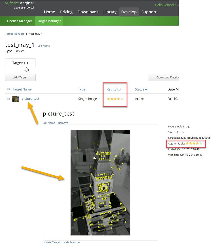

There are  no  other special options as setting  to do this in Studio but in generally this could be significant improved  when you  pay attention to follow the following  recommendations (this is for Vuforia engine but the most is also valid for image targets in studio: "Optimizing Target Detection and Tracking Stability"
Additionally you can check the quality of you picture on the Vuforia dev web
https://developer.vuforia.com/vui/develop/databases (requires account - I think for the first time free)
