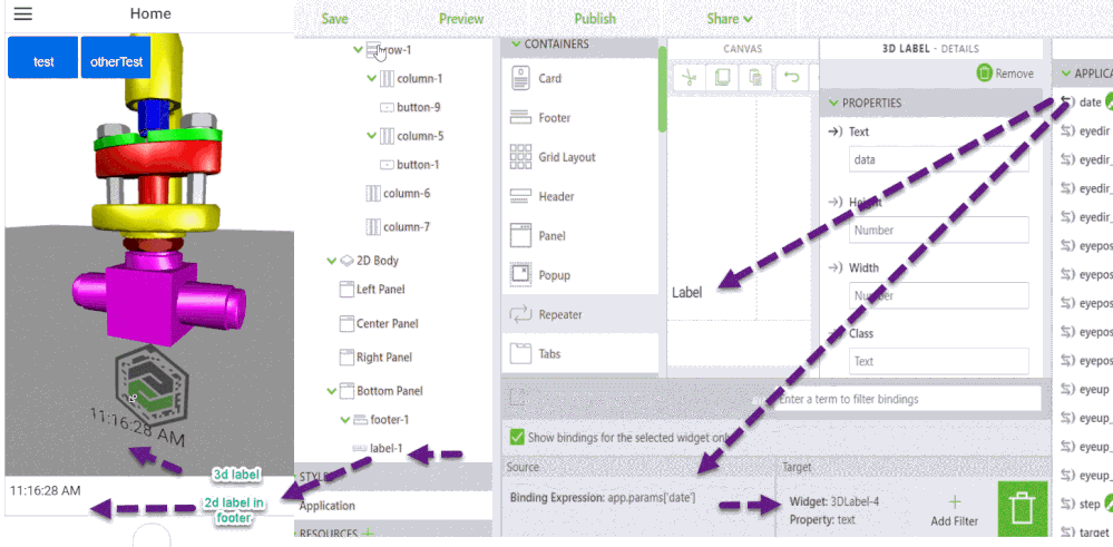

I am trying to write coding in Java script to show different country time in vuforia studio for Thing mark .
Is any body know the coding can you share with me.
Hi @thrinath,
so far I see the answer of @whity and @dupatel here is meant an simple app parameter as container of the value.
So this parameter is not related to any display of thingmark. So far I know you can not attach parameters on the thingmark. You can bind the e.g. date parameter to any 2d or 3d widges where you can see the value of this parameter.
so the code suggested by @whity  and addting some thing :
var timerId= setInterval(function(){$scope.showTime()},1500,true)
so to call the function every 1.5 seconds and to update the value of the date parameter. So this will update the valule of the date parameter with the current time and via the binding it will update the value of e.g. 3d label and 2d label as shown in the picture below:
So we can see in preview mode the time info as 2d and 3d label
But so far I know this will work first if the view (here Home)is  loaded-> means after scaning of the thingmark

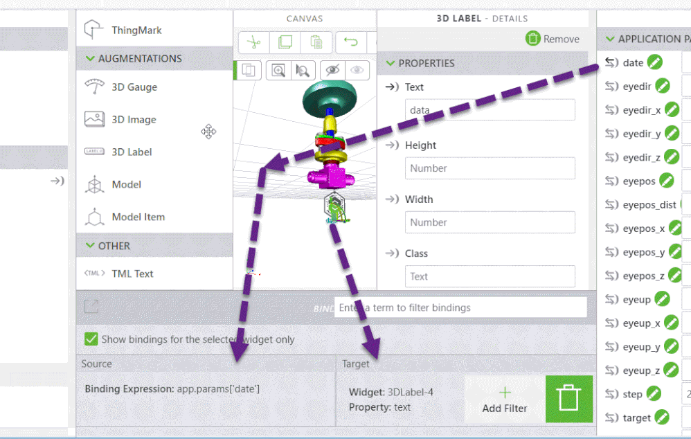

@thrinath  Directly adding the sample  code will not work. I used the application parameter named 'date' and setting its value to US date timezone using the JS code. Also, you can bind any widget text property to this application parameter which should appear in Preview.

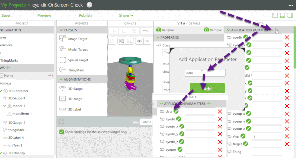

Hi sir,
where we need to add application parameter?
Is there any example files regarding the date and time on thingmark  can you share it.
Hi @thrinath,
Hi @RolandRaytchev
Thanks for you support.we followed as what you given in images and every thing is going good but while we giving preview  its not showing the time . we added 3d label and we created "DATE" as application parameter and we binded as you shown in images but solution is not coming.
thrinath
(To:thrinath)
Hi @RolandRaytchev
now we can see time & date on thing mark in preview and also as well after publishing the thing mark.
