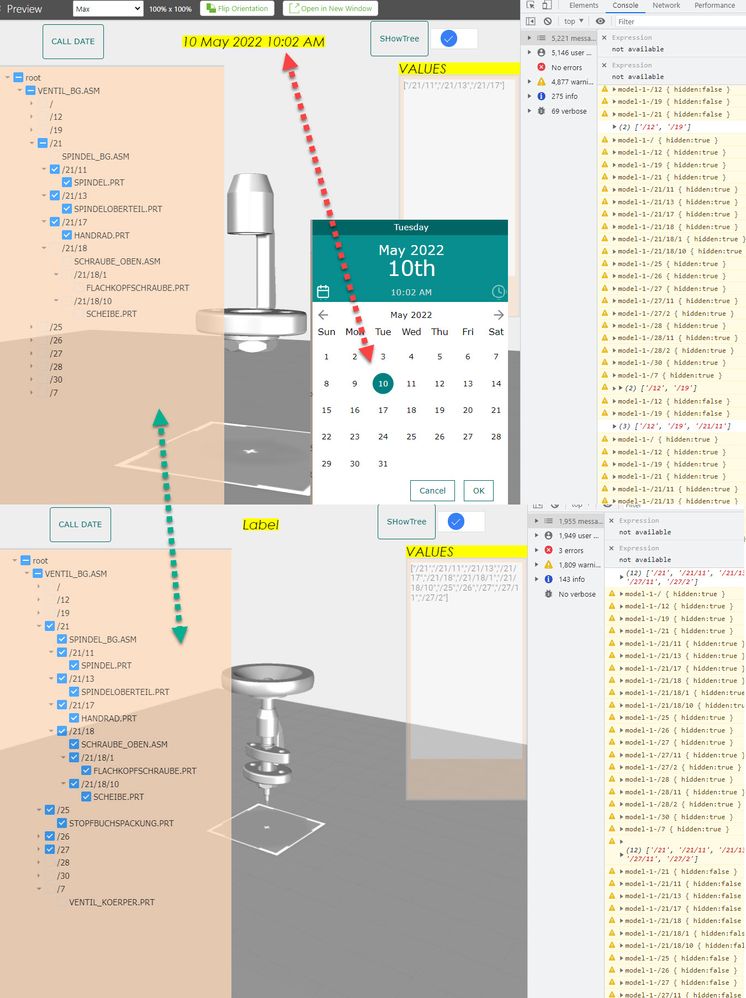

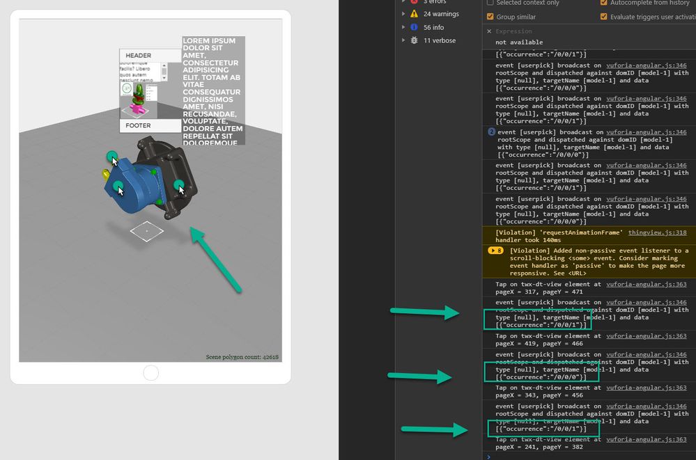

For example one test you can do:
Start you experience in preview and  press Strg +Shift +I - Keys to go in crome debuging mode and simple move the cursor about the model and click different components. What is the printing then?
Here an example:
So in the console we can see different occurance printing (means component Path Id)

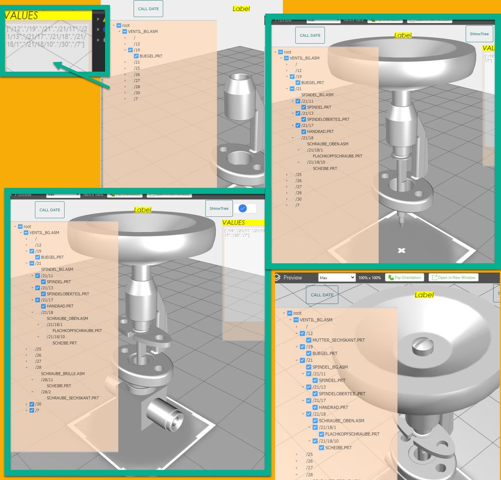

I would like to describe the starting situation with more detail. The models are created with Creo and saved in a .pvz file. These files are used to create AR Experience.
One idea is to make certain elements invisible or transparent. But that affects a lot of model elements. By uploading the .pvz file, the tree structure with components and sub-groups of the entire model unfortunately disappears, as you can see in the first photo. I only get a little structure if I select the indiviual model elements with the modelItem-widget (picture 2).
It is very tough to select the many model elements individually with the ModelItem-widget and so my question is whether there is a possibility that the components and substructures from Creo will be adopted.

here we need to understand the creo and vuforia studio platform these two software work differently. Tree structure in creo parametric (parts and subassembly) can not be viewd in vuforia studio as of now. you can only add model items to separte the parts from assembly in studio
Jan 18, 2021 4:40 PM UTC
Yes and NO.
Yes - agree that they are different and could not be compared directly. The one is design tool and Vuforia help us for the  visualization of the assembly in the reals word.
no - means in the meantime we have information about the component structure as json file to the pvz file when we imported the data with the option including metadata. This means we can request information about the component and parameters and we can move and rotate the components via setting of properties and javaScript. The movements used the same reference as they are design in the Creo Parametric assembly.
Here in this case so far understood the requirement of the original question the data is coming directly form Creo Parametric means the data is converted to PVZ and is not changed by Creo Illustrate.
In this case we have absolutely the same model Tree when we consider the component Paths and we will have additional information part names and Creo Parameters.. Ok we have not a tool which could display the Creo Parametric Element tree but with some programing work we can implement et least some UI to display the list in similar manner as in Creo parametric
