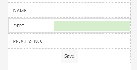

hi all,
I created a textarea in vuforia, how can i save this and where does the data goes?
