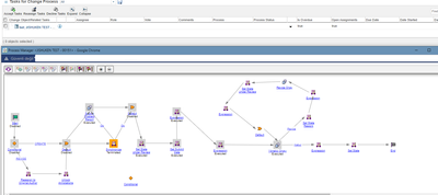

PS2: for better imagination 😄 Show screen shot of workflow that others can imagine where the code and task are run
PetrH

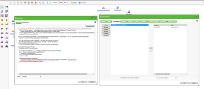

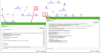

smcvr
(To:HelesicPetr)
Workflow:
Open Process Manager:
Code:
wt.org.DirectoryContextProvider contextProvider = wt.inf.container.WTContainerHelper.service.getExchangeContainer().getContextProvider();
     wt.org.WTGroup wgroup = wt.org.OrganizationServicesHelper.manager.getGroup(katilimci, contextProvider);
	 wt.query.QuerySpec qs = new wt.query.QuerySpec(wt.org.WTGroup.class);
     wt.query.SearchCondition sc = new wt.query.SearchCondition(wt.org.WTGroup.class, wt.org.WTGroup.NAME, wt.query.SearchCondition.EQUAL, katilimci);
     qs.appendWhere(sc, new int[] { 0 });
  for(wt.fc.QueryResult queryResult = wt.fc.PersistenceHelper.manager.find(qs); queryResult != null && queryResult.hasMoreElements();)
     wgroup = (wt.org.WTGroup)queryResult.nextElement();
     java.util.ArrayList<WTUser> members = new java.util.ArrayList<WTUser>();
     java.util.Enumeration<wt.org.WTPrincipal> member = wgroup.members();
  while (member.hasMoreElements()) {
     wt.org.WTPrincipal principal = (wt.org.WTPrincipal) member.nextElement();
  if (principal instanceof WTUser){
     members.add((WTUser) principal);}
    wt.change2.ChangeIssue ci =( wt.change2.ChangeIssue)primaryBusinessObject;
    wt.team.Team team = wt.team.TeamHelper.service.getTeam(ci);
	 wt.org.WTPrincipal wtprincial = members.get(0);
        wt.project.Role role = wt.project.Role.toRole("Submitter");
      if (role == null) {
      team.addPrincipal(role, wtprincial);
      team.addPrincipal(wt.project.Role.toRole("Submitter"), wtprincial);
      wt.fc.PersistenceHelper.manager.save(team);
      team = (wt.team.Team)PersistenceHelper.manager.refresh(team);
I got the variable "kilimci" as a string from another expression. I changed the code as you said, it does not show an error in the code. There is no error in open process manager, but when it comes to the activity, it shows as completed and does not send me a task.

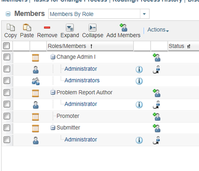

Also check the Member Participant list in a detail page of the primary object at a process tab
