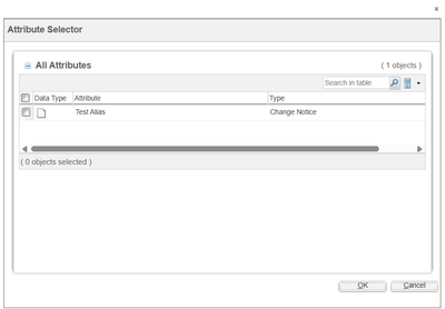

Use Case: I am trying to setup an "Advanced Search" against the "Change Notice" object type. However, I have noticed I have no option to add any "Attributes" into the "Criteria" section of my search. Please refer to the attached image.

I have noticed that I can select other object types which provides the opportunity to add attributes into "Criteria" section of the search. Can anybody suggest why I don't have this option for the "Change Notice" object type?

I was able to reproduce the issue to some extent.
I encountered the same error on my system.
2026-01-28 09:28:43,942 ERROR [ajp-nio-127.0.0.1-8010-exec-4] com.ptc.core.lwc.server.cache.AttValidatorHelper pdmadmin - Invalid mapping value: ~theChangeRequest2^xxx_ChgMgmtReview~state.state com.ptc.core.meta.common.impl.LogicalAttributeFormatException: Unable to find logical attribute: "xxx_ChgMgmtReview"
at com.ptc.core.meta.common.impl.LogicalIdentifierFactory._translate(LogicalIdentifierFactory.java:770)
at com.ptc.core.meta.common.impl.LogicalIdentifierFactory._translate(LogicalIdentifierFactory.java:504)
Steps to reproduce
I attempted to add the alias attribute created on the Change Notice to Advanced Search using the following command
xconfmanager --add advancedSearch.wt.change2.WTChangeOrder2=testAlias -p
After executing this command, the other attributes are no longer visible.
