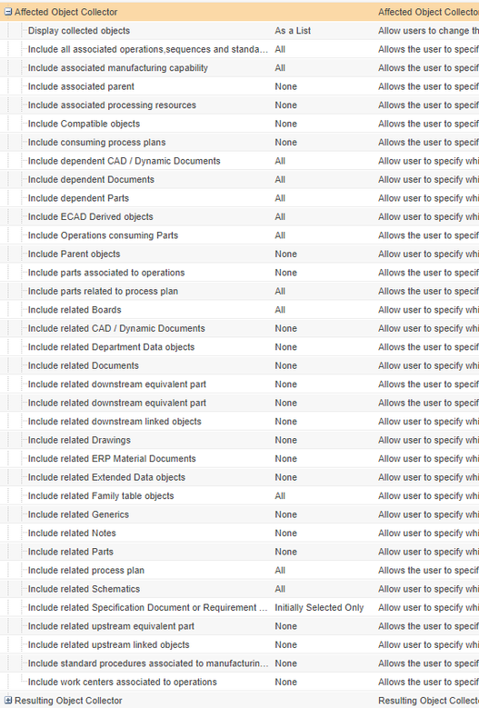

Hi @DKWc
Yes, I have a suggestion
Go to the preference management-> change management and play with the Collectors options for affected / resulting tables
Based on the options in the preference management, a function collect objects will collect all what you would need.
PS> not perfect but it works.

Hi Petr,
Thanks for reply.

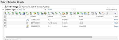

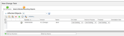

Tried out the recommendation, however it dosen't gets collected in affected object but gets in collection.
Any suggestions to get it populated in affected objects.

Yes, It works that way.
