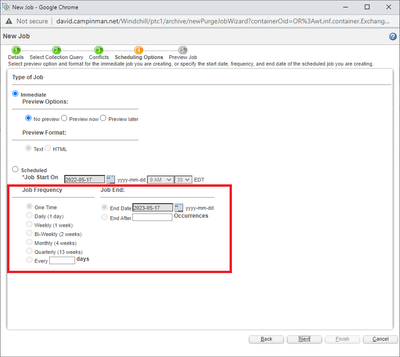

@Keerthivarman Automating regularly scheduled purge is OOTB functionality.
You need to take advantage of step 4,Scheduling Options, allows you to set the frequency of the purge job.
David

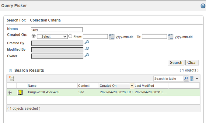

I'll write it down here.
what are the steps I'm doing.
First I'll create a query in which I'll select the context and required old files to purge as shown below.
and next i'll go for scheduling,
in create new job i'll select the created query and schedule the purge at the given time.
All these steps are doing manually at the year end. Is there any way to automate the whole process which I mentioned here.

Got it.
@Keerthivarman
This can be done automatically but not OOTB.
To be clear you want to automate the query creation based on the previous year's number to select all folders under Project-<previous year>
This is definitely doable and could be setup to be created annually and used by the Purge Job which would also be run annually, for example.
But again, while this is definitely doable it is also NOT OOTB.
