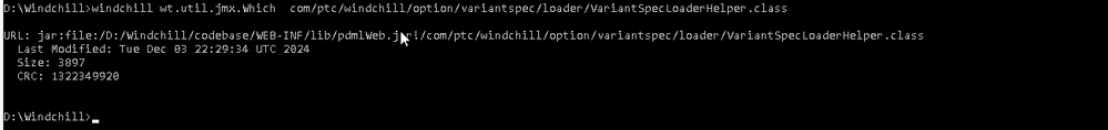

It is exactly what I need, but I am missing the library (.jar) where the class (VariantSpecLoaderHelper) can be found.
Can you help me to find it?
Fadel
23-Emerald I
(To:Lukasz1)
Hi ,
see below
Fede
