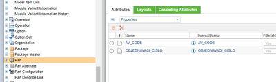

I have a Data Utility were I process the attribute values using the gatDataValue(). But the data utility does not get called for Common Attributes(allNonSchemaNonClassificationMinusClassificationRefIbas) in a WTPart.  If the attributes are listed maybe I can assign the selector in the Layout attribute properties but for Common Attributes the attributes are not listed but I see just one cell with value "allNonSchemaNonClassificationMinusClassificationRefIbas". Can anybody help me know why?

Hi @MV_10441462
Try to share some screen of the attribute.
If the attribute is created on the WTPart then you have to be able to add them to the layout group
in this point, you can have one attribute just in one layout. So if you have more groups in one layout then each attribute can be added once.
PS> if you add the allNonSchemaNonClassificationMinusClassificationRefIbas to a group, then you can not add another attribute to that group.

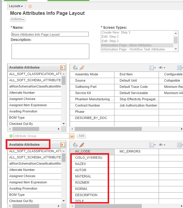

Hi @HelesicPetr
Exactly. My requirement now is to remove the attribute from the group allNonSchemaNonClassificationMinusClassificationRefIbas and add it to another Layout Group from the available attributes so that the attribute does not occur twice(once for the group and other manually) in the same page.
Hi @MV_10441462
