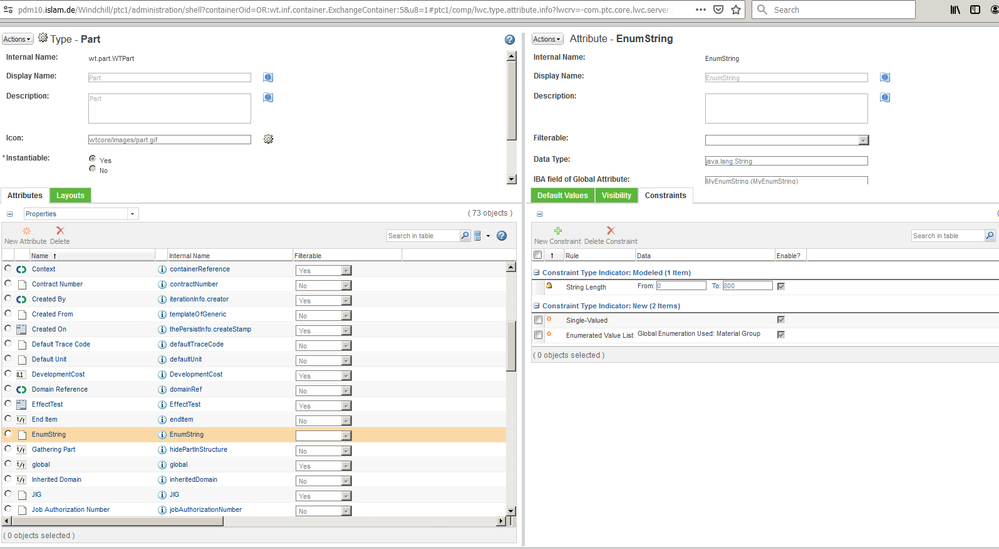

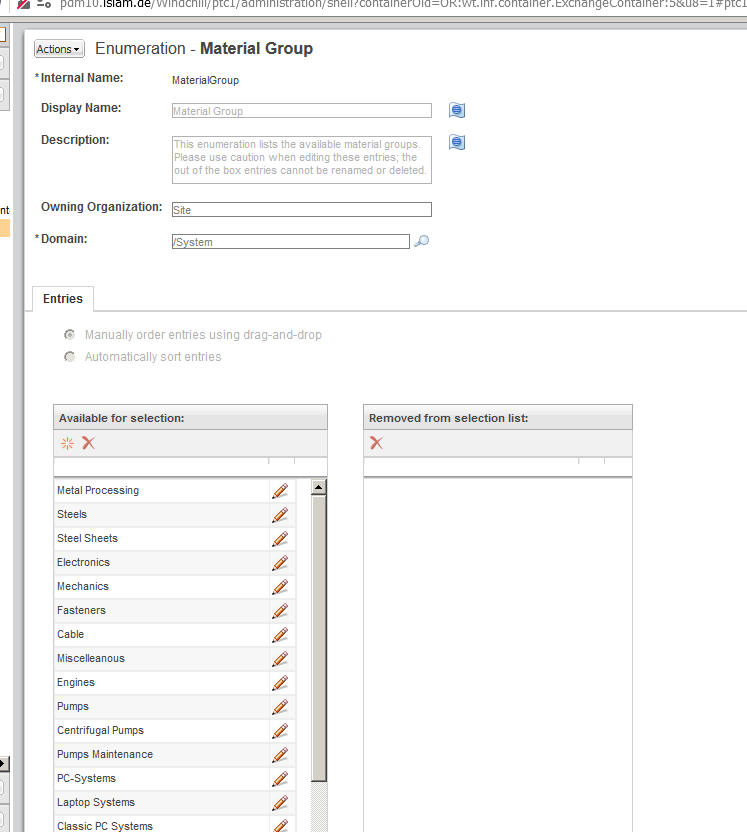

  • Here an illustration with a custom enumtype (adding an IBA linked to a  Global Enumeration).
Create an entry in Parts.json, specifying a new attribute. As it is an enumeration, I will add the following :
                               "name": "EnumString",
"internalName": "EnumString",
"type": "PTC.EnumType"
In Parts.json, findable in codebase\rest\ptc\domain\ProdMgmt\v2\entity\Parts.json
Then it will look like this :

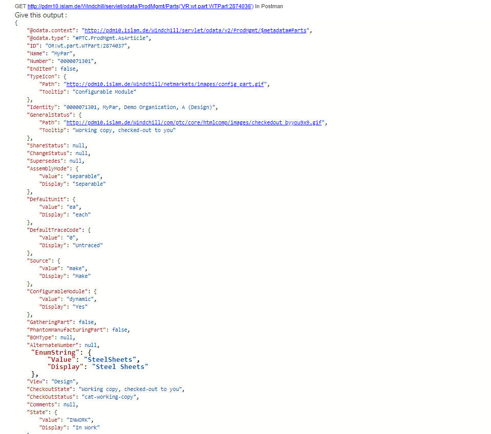

Without restarting Windchill :
GET http://pdm10.de/Windchill/servlet/odata/ProdMgmt/Parts('VR:wt.part.WTPart:2874036') In Postman
Give this output :
    "@odata.context""http://pdm10.de/Windchill/servlet/odata/v2/ProdMgmt/$metadata#Parts",
    "@odata.type""#PTC.ProdMgmt.AsArticle",
    "ID""OR:wt.part.WTPart:2874037",
    "Name""MyPar",
    "Number""0000071301",
    "EndItem"false,
    "TypeIcon": {
        "Path""http://pdm10.de/Windchill/netmarkets/images/config_part.gif",
        "Tooltip""Configurable Module"
    "Identity""0000071301, MyPar, Demo Organization, A (Design)",
    "GeneralStatus": {
        "Path""http://pdm10.de/Windchill/com/ptc/core/htmlcomp/images/checkedout_byyou9x9.gif",
        "Tooltip""Working copy, checked-out to you"
    "ShareStatus"null,
    "ChangeStatus"null,
    "Supersedes"null,
    "AssemblyMode": {
        "Value""separable",
        "Display""Separable"
    "DefaultUnit": {
        "Value""ea",
        "Display""each"
    "DefaultTraceCode": {
        "Value""0",
        "Display""Untraced"
    "Source": {
        "Value""make",
        "Display""Make"
    "ConfigurableModule": {
        "Value""dynamic",
        "Display""Yes"
    "GatheringPart"false,
    "PhantomManufacturingPart"false,
    "BOMType"null,
    "AlternateNumber"null,
    "EnumString": {
        "Value""SteelSheets",
        "Display""Steel Sheets"
    "View""Design",
    "CheckoutState""Working copy, checked-out to you",
    "CheckOutStatus""cat-working-copy",
    "Comments"null,
    "State": {
        "Value""INWORK",
        "Display""In Work"
    "Comments"null,
    "State": {
        "Value""INWORK",
        "Display""In Work"
if it does not work please expose here how you are driving this use case.

I used to think that enumerations have only one name and several values.
But in your example it looks like a key - value.
"EnumString": {
"Value": "SteelSheets",
"Display": "Steel Sheets"
Do I understand correctly?
How can I do it?
Thanks in advance!
hlafkir
(To:VladiSlav)
HI, follow these screenshots :
create an IBA and add constraint enumerationcreate an IBA and add constraint enumerationthe global enumeratoin to be added into the IBAthe global enumeratoin to be added into the IBAafter creating a part and added a value to the attributeafter creating a part and added a value to the attributePostman responsePostman response
Hope this is now clear 🙂
