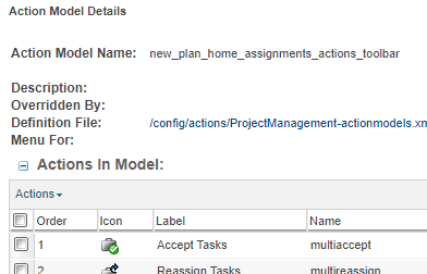

If so you need to crate new wizard where you add the Context selection step and add it to some table on the homepage.
You can use the My task table to add that action
